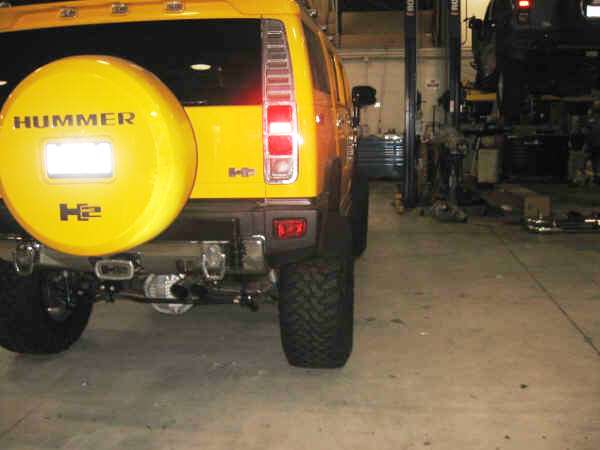

Here is a 37 inch, 15.5 width on one of my rigs (does have a 6 inch lift though!) back spacing is 4.5.
