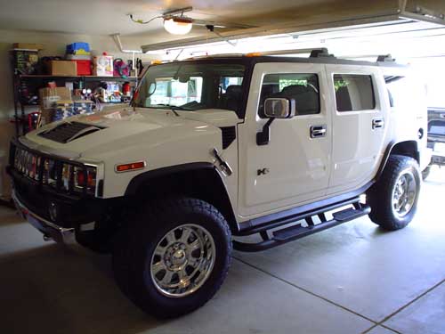

Here's a pic of the 325/60R20 on a 20x11" rim.

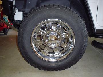

I just installed a set of 20x10 Racelines with 325-60-20 Nitto Terragrabers and they fit fine. They do rub in the front only when you turn all the way left or right. Its only hitting the plastic wheel well a bit, not too bad. BIG-C
Old 04-12-2004, 04:37 PM
Circuitguy
Here is one more! BIG-C
